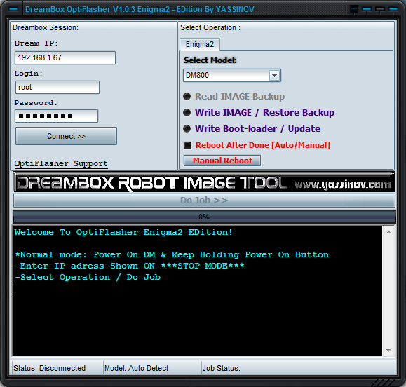

Hi thanks for the post
Dreambox OptiFlasher Enigma2 EDition [DM800/DM800SE]
Version 1.0.3
Main Features:
-Performing IMAGE Writing Operation [NFI]
-Performing IMAGE Backup Restore [NFI]
-Performing Boot Loader Writing/Update Operation [NFI]
-Performing Manual/Auto Reboot
Best regards , yassinov
Hope solve your problem
Version 1.0.3
Main Features:

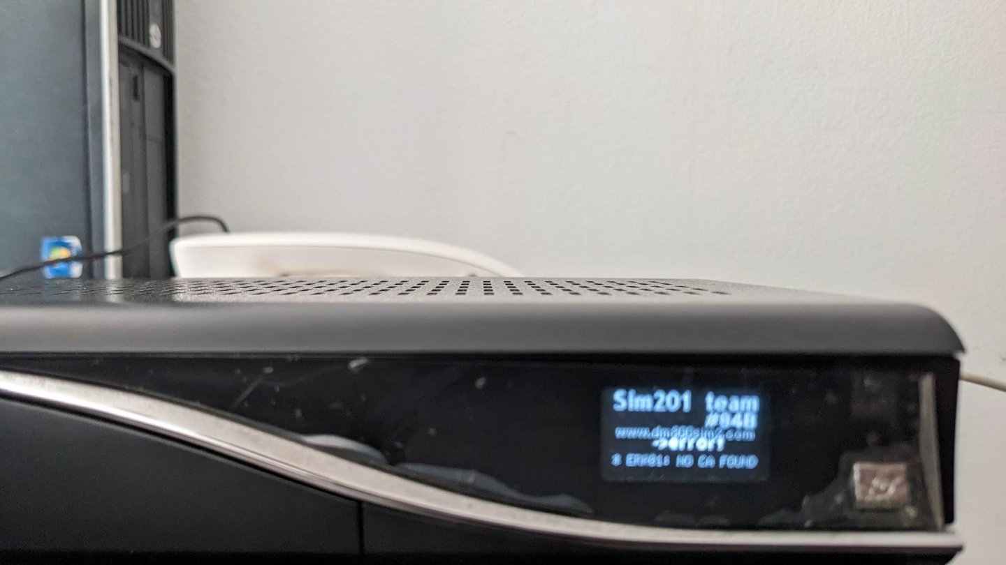

Re: DM800 HD - ERR01 NO CA FOUND
Screenshot attached.
Sim 201 team 84B
Sim 201 team 84B
