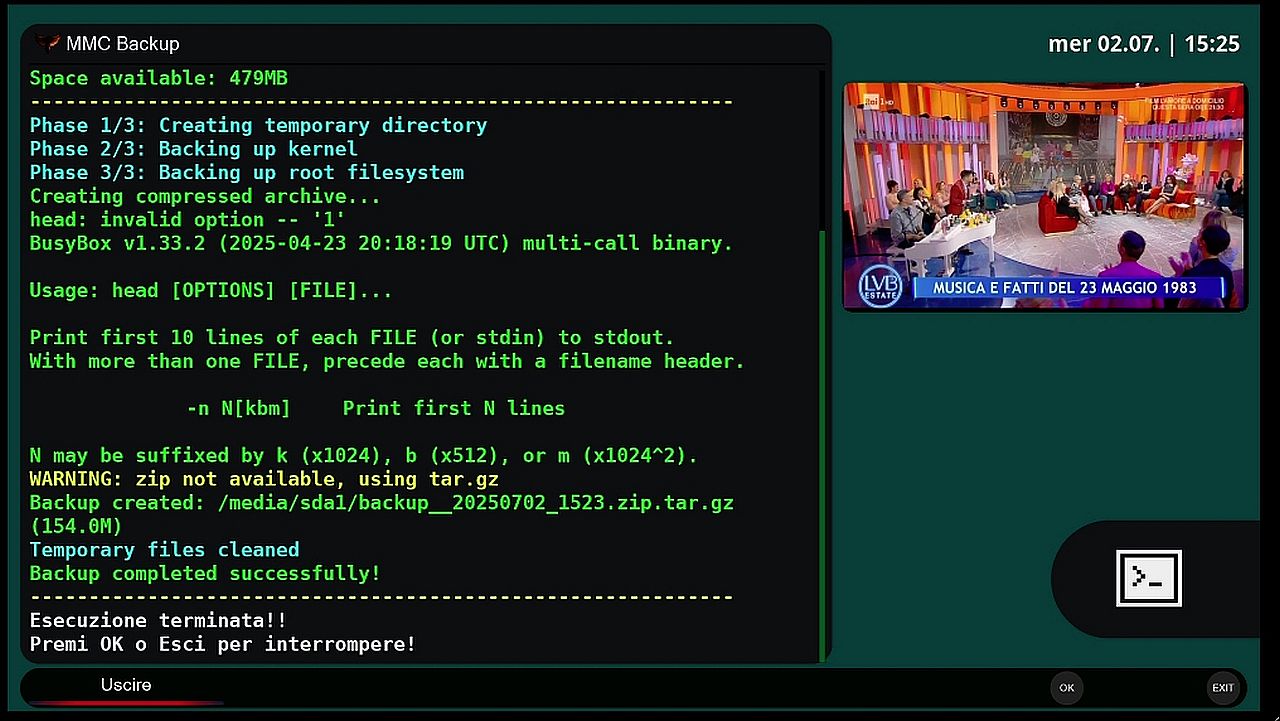

- enigma2-plugin-extensions-backupsuite_3.0_r6_all.ipk
- (284.07 KiB) Downloaded 50 times
- Hannibal_Lecter
- Posts: 15065
- Joined: 27 Mar 2024, 15:29
- Has thanked: 15 times
- Been thanked: 2735 times
Re: BackupSuite 3.0
-fix name zip with model
-fix error on grep model (mmc)
Fixed this error
work very fine
thx Lululla
Fixed this error
work very fine
thx Lululla
- enigma2-plugin-extensions-backupsuite_3.0-r8_all.ipk
- (1.85 MiB) Downloaded 46 times
