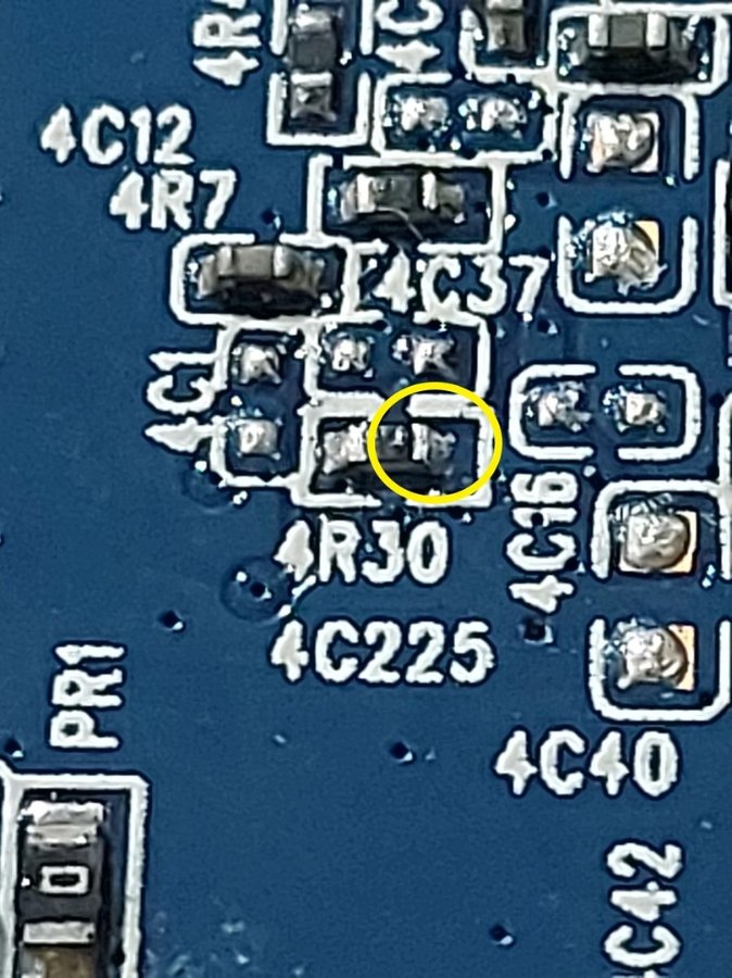

3. Locate the reset button (if you have one) on the bottom of your Combo. (IF NOT - See the end of this post)
(It is a small golden button seen on the circuit board, it can be pressed with a toothpick - hair clip or similar.)

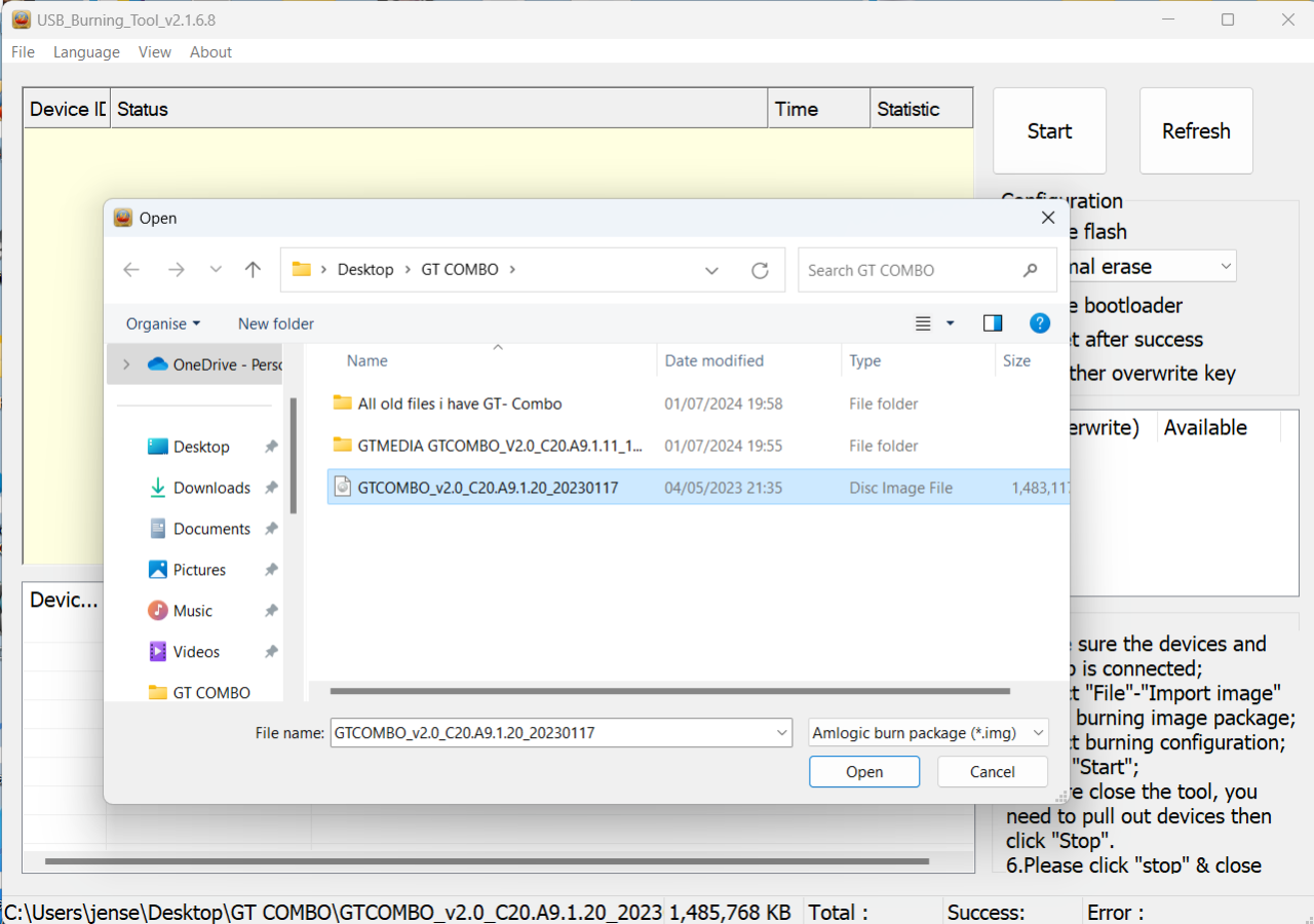

4. open USB Burning tool
5. load the .img firmware with usb burning tool (click on file file-import image) --- The tool will then check the firmware, give it time to complete.
6. press the start button on the usb burn tool software and wait a few seconds.
7. Press the reset button on the GT Combo, and keep it pressed in.
8. Connect the Combo power cable and wait, ---- After a few seconds the USB Burning Tool will begin to work.
(on my PC the combo first shows up as a new device, then the Tool begins to work)
9. You can now release the combo reset button
10. Wait patently while the tool dose its work
